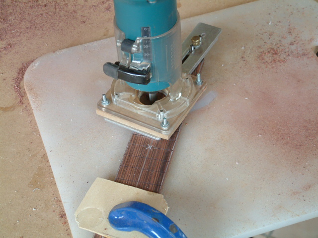

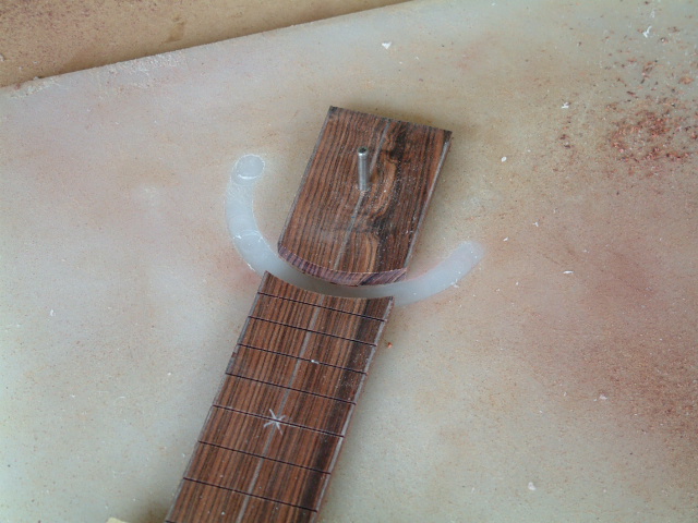

I use the same method as I use to cut the soundhole - with a laminate trimmer. I try and match the end of the fingerboard curve to the soundhole edge and my fingerboards are usually long enough that I can drill the hole for the pivot pin and make the cut (remember that the outside of the soundhole radius measurement goes to the outside edge of the router bit - and if you are binding the fingerboard akkow for this as well). I also cut from each edge and meet in the middle to avoid the router bit chipping the edges. Here's a couple of pics that should illustrate the technique:

Dave,
I have the Stew-Mac Soundhole/Rosette Routing Jig as well. This is the first thing I thought of that I would like to use. Your photo helps out a lot as I have been wondering on how to line everything up.
The only thing is that I don't have enough length (waste material beyond the end of the fretboard) to put the pin in. What do you do in this situation?

PostPosted: Tue Oct 31, 2006 12:30 pm
double stick it to a carrier board?
PostPosted: Tue Oct 31, 2006 12:36 pm
Ya, what michael said. Use a carrier board with a shim where the router extension will site. Make sure it's the same height as the fretboard and your good to go..

What is a carrier board??
Guitars...One's too many...Twenty is not enough.
PostPosted: Tue Oct 31, 2006 2:04 pm
a board you mount a workpiece to to hold it whilst you work on it. in the case mentioned above wherein the fb was not long enough to reach to the pivot point of the circle cutter, a carrier board would provide the needed length and hod the fb in position to cut the arc in the end.
PostPosted: Tue Oct 31, 2006 2:47 pm
Doug a carrier board is also a board many people use to support thin pieces going through a thickness sander or a planer.
But in this instance, in Dave White's picture above, the white board which he clamps the fb to is the carrier board. Just think of his picture, with your fb clamped or double sided taped to the board and a second piece, the same thickness as your fb where Dave's long extension is. Than you drill your hole in the second piece that is the correct radius from the fb that you want to create.
Clear as mud?Rod True39021.9511458333
